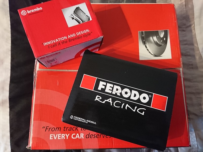

George@RTR has been a legend and sorted me some Brembo High Carbon Discs and Ferodo DS2500 pads. I also ordered some standard Brembo pads for the rears.
Can't wait to get these on, just need to order some braided lines and decent fluid. But my dilemma is whether to fit these now or wait until the steering rack is changed before the MOT in Feb.
