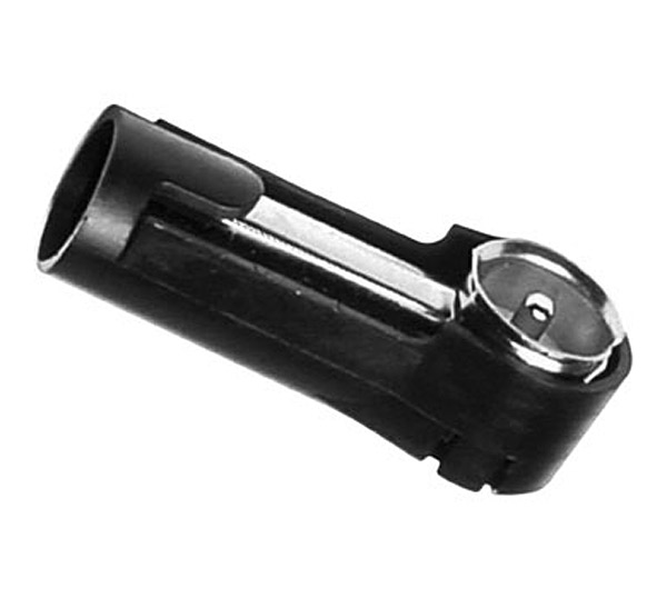

For the radio aerial, both ISO and DIN are around in different cars, a lot of cars have the antenna terminated in a DIN connection, that you would have to change to ISO to use in a different radio.
The aerial in your photo is DIN, so you'd have to get an adapter like this to connect it to the back of your Renault radio:
I thought my aerial was already ISO in my Clio but it's possible there was an adapter on the end of it already like the one in the link and I didn't clock it (I was busy cursing trying to run cables through my dashboard at the time, I actually "lost" my antenna in there and need to fish it out later lol)

I’m a bit confused, though… what I have currently was connected to an aftermarket unit and in the link it says that “An DIN to ISO aerial adapter is sometimes required when replacing your original factory fitted car radio head unit with an after-market head unit”.
Either way, I’ll take your word for it. It’s just a few bucks and I’m ready to get this stock radio put in.
