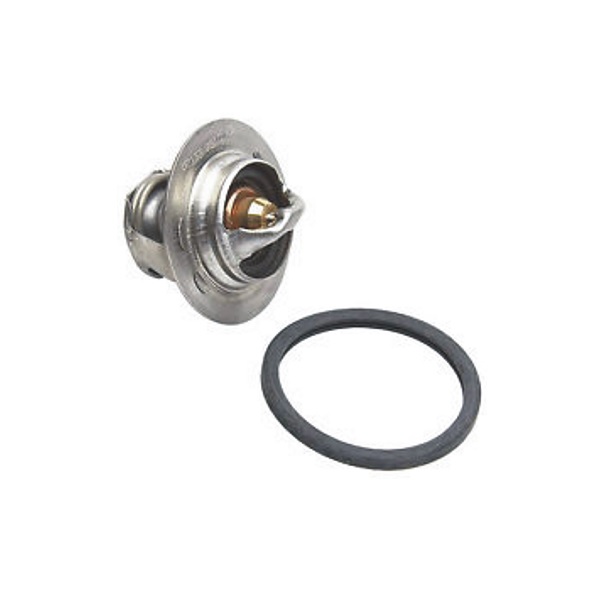

Hi fella, yeah thermostats are common to go on these. It's a simple job to replace but make sure you buy a genuine thermostat as the standard ones are rated slightly higher than the original part (can't recall the correct figures).
Genuine Renault part number 8200772994
As I mentioned above - easy to do if you're familiar with a spanner, takes ~30 mintues including topping it back up and bleeding.
Make sure you have some coolant to top it back up with. Probably a decent time to do a coolant flush/change too. :smile:
